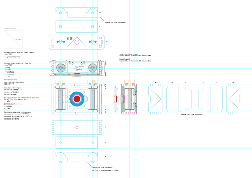

I definitely caught the bug - the pinhole bug! This time, it is a 6x6 format camera. This takes standard 120 roll film which is a fairly easy system to develop since there are no sprockets to make gears for like 35mm film. My last camera, the 4x5 takes sheet film so I only needed to create a light tight box. This time, the challenge was to design a film transport system that includes a window to check the exposure number. For those of you who are not familiar, 120 film has a light proof paper backing with an exposure number printed on it so you can check from a small (usually a deep red) window, how far to advance the film for each frame. I am sure there is a proper wavelength to prevent fogging the film but for this camera, a generic, deep red acrylic would have to do.
For those of you who are interested. All of my designs start with a simple top, front, and side view. In this case it is a box with dimensions of 56mm x 56mm x 30mm.
This is because the image size of a 6x6 photo is 56mm x 56mm (allowing for a 2mm border). The 30mm is the focal length (projection distance) for this pinhole which is .2mm. Everything else is built around that box. By the time you start adding layers to create light baffles, structures to support a film transport system, the exposure indicator window, material thickness and so on, you get this:
This is only the top and sides. I have the front/back schematics on another layer. Breakdowns of the winder mechanism and exposure window are on yet other layers. You can also see all of my calculations. Thickness of the material I am using is on here as well. It’s different each time so always measure before you design! I use Adobe Illustrator. I have 3D programs but I don’t know why but I prefer this approach. I think it is because we are cutting flat planes to create a volume and not adding materials in space like 3D printers. Whatever works for you. This works for me.
