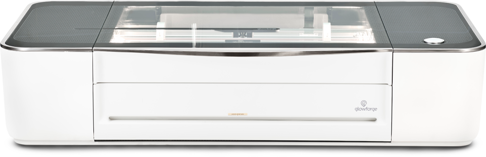

Our Pro model is designed for frequent, shared use, like a makerspace. It comes with upgraded optics, tube, and cooling. The passthrough lets you use long materials. The Pro is a Class 4 laser product that requires additional safety precautions. Includes an Air Filter.

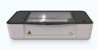

Our Basic model can create everything shown on the Glowforge home page and is perfect for home, hobby, or occasional shop use. It needs ventilation via the provided 4″ diameter (10.2cm) hose through a window or dryer vent.

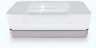

What’s an Air Filter and who should buy one?
Lasers normally require ventilation to the outdoors, for example through a window or dryer vent. Our optional Air Filter that sits under Glowforge and ventilates using HEPA filters and charcoal, meaning no outside ventilation is required.
Dimensions
- Glowforge exterior (Pro and Basic): 38″ x 20.75″ x 8.25″ (965mm x 527mm x 210mm)
- Air filter exterior: 38″ x 20.75″ x 7″ (965mm x 527mm x 178mm)
