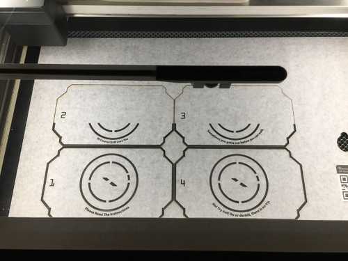

I hit the print button in the UI and see that the op is going to take about 2hrs. Okay Cool. Hit the button on the 'forge and and handled some support tickets for work. About 1.5hrs into the op I had to goto the restroom. (You know, typing that out on a forum seems- weird. But the point is I walked away from the 'forge.) I get back and noticed that the office is quiet. I look in the unit and find this.
Seems like the glowforge wanted to take a siesta.
I went into full nerd rage super saiyan 3. One. That was the last piece of black acrylic I had. Two. Why fail at the end? Why do it when I leave? (Anyone who owns a CNC or 3D Printer will understand this. Seems like these machines plot failure when you are not looking so you can’t see that the hell happen.)

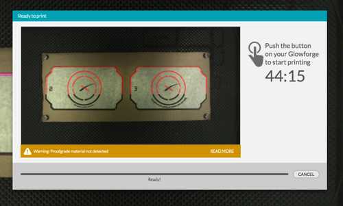

So the things I have. I have the source file and the part. I alt-tabbed to Illustrator and rescaled the image on my display to the size of the part that’s in my hand.
Then used the guide rule to line up to where the failure happened. Then used the trim tool to remove the area that was already engraved. Then removed the other assets that’s already been engraved. But I kept the cut line intact.
Loaded the 'forge with a fresh sheet of cardboard. Used some magnets to keep it in place.
I set the engraving to ignore and set the cutline to cut.
Pulled out my weeding tool so I can pull the inserts out with disturbing the jig.
Now I set the cut line to ignore and set the other asset to engrave. The picked ‘black acrylic 1/8"’ in the materials menu. Then loaded up the failed pieces.
Okay- I must have watched that preview playback at least 10 times before I pressed the button on the 'forge.
Okay- Lets do this.
