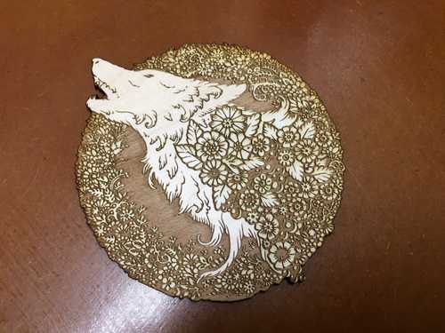

Proofgrade was a dream. All the settings worked first time out. This came out great. 24 minutes to engrave and cut on 225LPI. 1/8 birch ply. Im going to have to do a test on my k40 to see what a comparable cut would take time-wise. I can tell you its WAY longer.
Making an SVG for the forge is really easy and straightforward. I made two layers for this guy. One was the outer cut line - stroke with no fill, the other was the engrave - fill no stroke. Boom, was ready to go!
