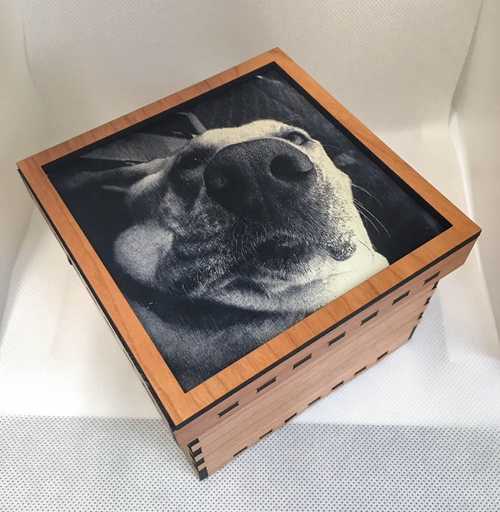

For those of you who have cut laser tiles and weren’t sure what to do with them, I had the same dilemma with a tile i had made of my brother’s dog who passed away last summer. Wanted to send it to him, but not as a plain tile, since I wasn’t sure what he would be able to do with just a tile.
So I decided to make a box lid to accommodate it and incorporate it into a box.
I made two box files on boxes.py, both without lids. I made one box just barely big enough to accommodate the laser tile and one about 3mm smaller so the lid box would slide over the regular box. added a couple of millimeters below the slots so it would be a deeper lid, created a lip piece to glue on top and cover the edges of the tile, and there you go.
I uploaded the cut file to free laser designs if anyone else would like to use it.
