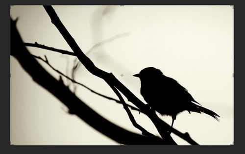

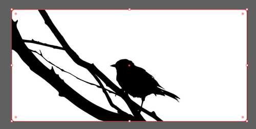

Yesterday I was poking around my Aperture library (Yup. Aperture) and I found an old image I took eons ago with an old Olympus E300.

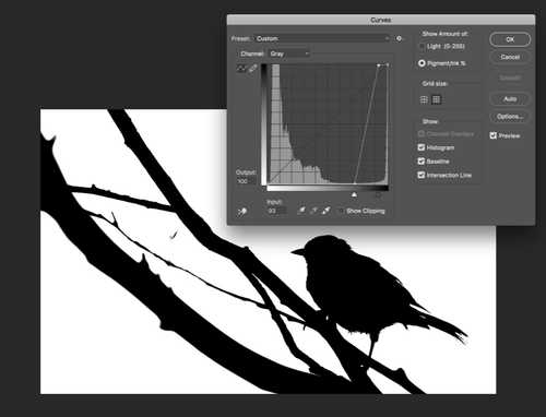

I opened in Photoshop and converted it to greyscale and used the curve tool to crush the details and make the edges more pronounced.
Then imported it into Illustrator and vectored it and added a border.

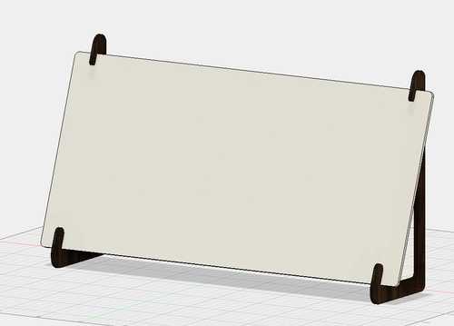

Exported border and imported that to Fusion 360. Then designed the stand.

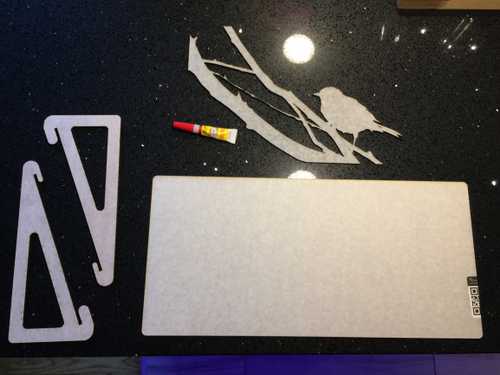

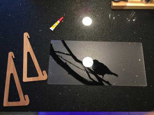

Then exported everything out as SVG and cut everything out.

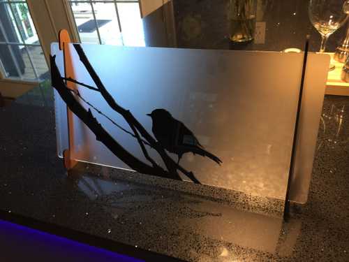

Assembly time.

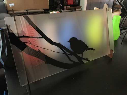

Actually looks better than I envisioned.
