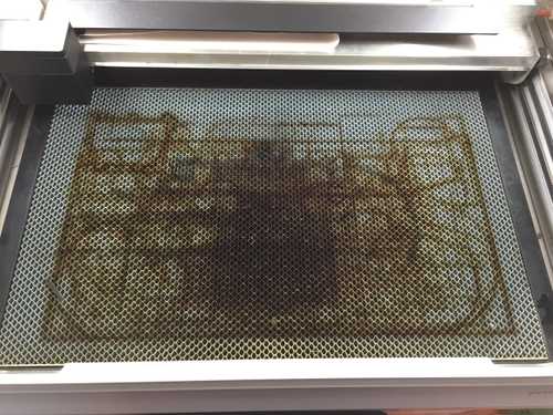

My glowforge had some mileage on it when I got it. Then I added even more mileage since I’ve owned it. The honeycomb has definitely seen some better days.

This is what it looked like before I cleaned it.
This is the after.

- Fill a bucket with hot’ish water and add simple green.
Big Bucket.
- Remove the honeycomb from its housing.
The process is pretty easy. 4 philips screws and 4 M3 screws.
- Insert honeycomb in bucket.
Depending of the size of the vessel let soak 5mins per side. Then agitate the bed in the bucket similar to a washing machine.
Use a plastic bristle brush to scrub surfaces. Set aside to dry.
Then grab the pan and the bed chassis and clean them.
- Allow everything to dry.
- After everything is DRY reassemble.
