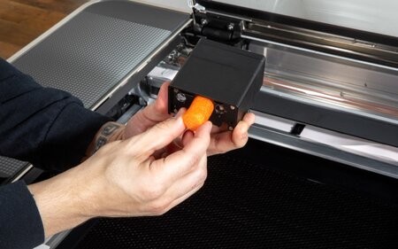

Carefully pick up the Print Head, touching only the flat, black metal parts. Do not touch the yellow window on the side of the head.
Remove the orange foam cylinder.
Holding the Print Head by its sides, connect the ribbon cable with its tab facing up. Slide the connector on until it clicks.
Connect the Print Head to the laser arm. With the Glowforge logo facing up, rest the Print Head on the laser arm’s metal plate until you feel the magnets click the head into place.
