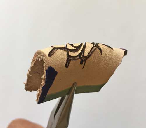

While you could probably cover up the discoloration well enough with dye and/or paint, the cuts were just too deep. The effect is really exaggerated in this photo with the leather bent up, but hopefully it helps to illustrate my point:
So when the new “precision power” settings were announced in the (early) July update I was really excited to give this experiment another try. The photo below shows my first attempt with the precision settings, just over a week ago. For consistency’s sake, I used the same little bee design, printed on 5-6 oz leather, at the same tiny size (all of the bee prints are approximately 1.25" square). The one on the left is the one that I did back in April, with the power dialed way down. The one on the right was printed about a week ago using PG settings for thick leather:
See how much lighter the newer one on the right is? When bent, you can see that the newer version still has a very fine cut where the leather was engraved, but it is nowhere near as deep as the earlier attempt. This cut does not pierce down into the lower, shaggier layers of the leather:

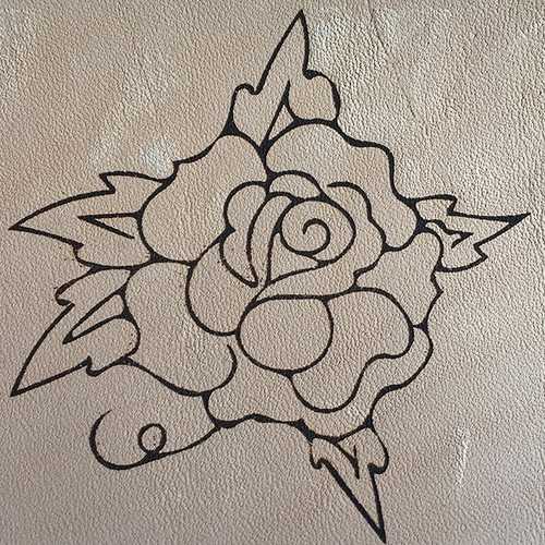

These last two photos show a little rose that I doodled. This image was also engraved using PG settings, but it was printed a bit larger than the bees, at about 2.75":
Here it is with a little bit of tooling:
It’s worth a disclaimer that I don’t do a whole lot of tooling in my work, so I’m not terribly skilled in these techniques. I can do passable leather tooling on small accents, but I rarely do large or involved tooling work. There are several forum members who are more experienced with leather carving and tooling, and they’ll likely have more insight (as well as better results :wink: ). Still, I wanted to offer up these photos to tide folks over for the time being. Hopefully it gives a better idea of what you’ll be able to do with the laser + traditional leather tooling methods.
