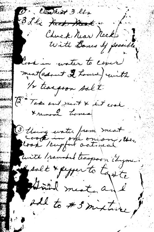

One of the challenges is deciding how deep to engrave, what to keep in the image, what to highlight and what to discard. My image processing skills are fairly basic but I managed to achieve a decent effect. I could have just imported this image after cropping the back ground cloth out and just did a straight greyscale engrave. After testing photo engraves though, I thought it might be better for a recipe to use the cutting board as the background and just highlight the text and some of the envelope and wear details. I opened it up in GIMP and used the fuzzy select to delete a lot of the dark ivory color of the envelope and boosted the contrast a bit. I then turned it into black and white. It was a challenge because of the blue ink and some of the ways the letters are made. I did a lot of zooming in and treating small sections because this would be a file I’d use many times. So here it is after processing.

First step was to combine the sides into one image.
And then I worked on turning the image in to a pure black and white image with minimal greyscaling. This was trial and error for me working in GIMP but I managed. I messed around with the color and curve and that was pretty interesting to get it into two basic colors, but what worked was simply taking up the threshold and sharpening the image. It was a bit tricky because the writing is so faint and thin on the original.

Here is the result of the cookie recipe engrave. I kept the scale of the recipe the same as the original so it’s a little big for the space of this smaller cutting board and not placed optimally. One of the things about masking is working on placement when it obscures material. Needed to make some marks on the masking to allow me to place the images better in relationship to how the cutting board grain and pieces go. I’m doing a an engrave on a bigger board and was more careful with the placement and scaling of the images. (1 hour engrave at this resolution).
