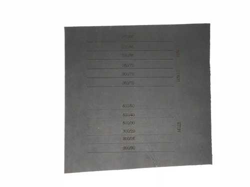

2. Laser Cutting a Prototype
Since this was my first leather project on the Glowforge, I decided to laser cut a test piece and try different settings. This was a simple square piece of leather where I had approximately 12 lines; 6 to test single and double pass cuts and 6 to test engraving settings. This is probably the smartest thing that I did because it helped me set a standard range for all of my future cuts with this thickness of leather. I hope this helps some of you out there who are looking to work with leather on your Glowforge.
